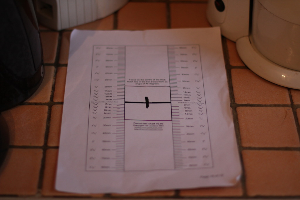

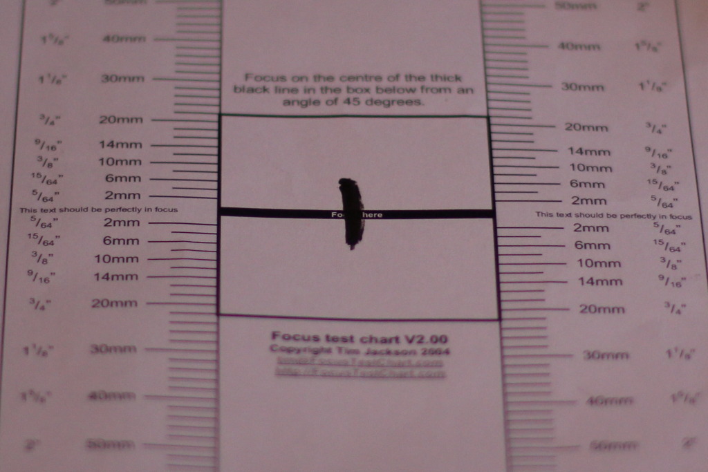

bon ben test sur mire OK:
- EXIF: Canon ( EOS 550D) | 50mm f/1.4 USM | 50mm | 1/200s | f/1.4 | ISO 400
zoom :
